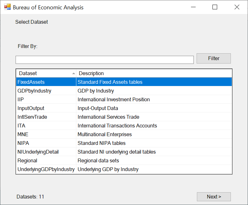

After you click Browse on database window (before you click Filter) do you see a list of datasets like the attached screenshot?
- bea_datasets.png (25.43 KiB) Viewed 28207 times

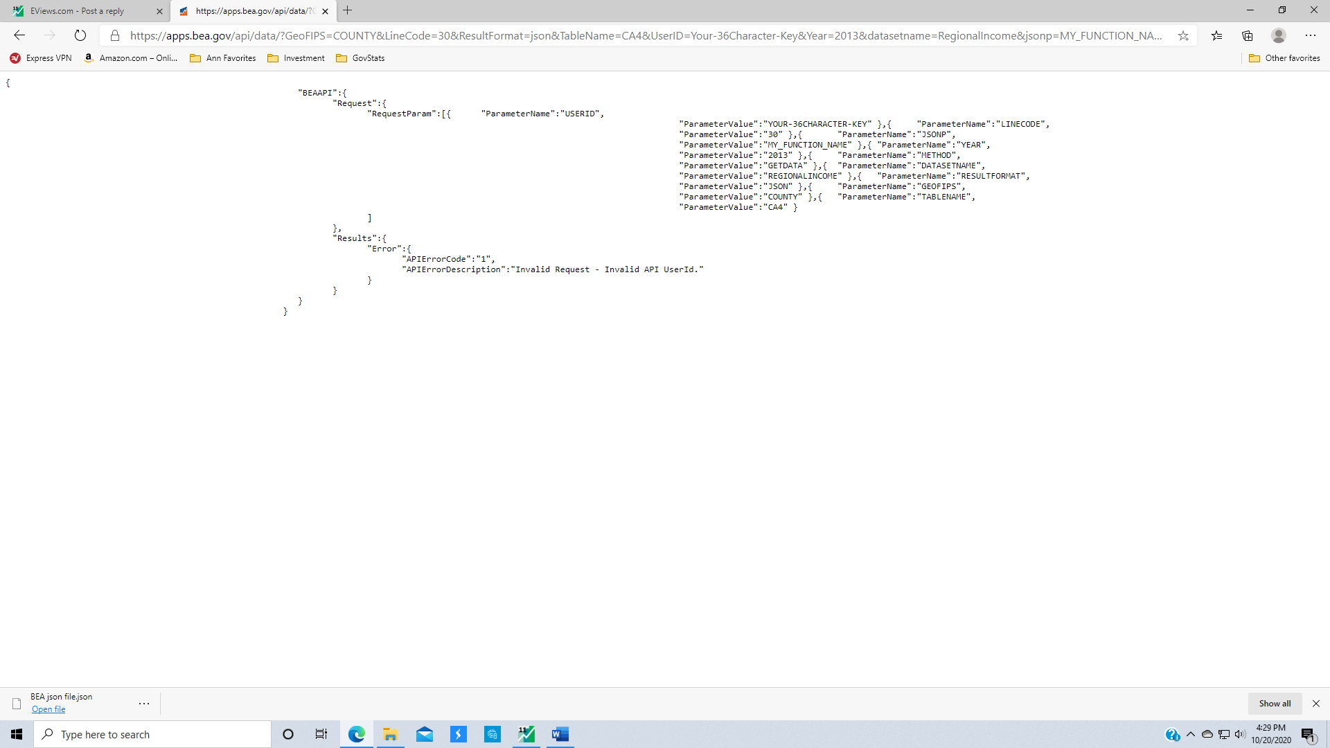

The attached file shows what I get when I key the code supplied for the BEAPPI, using my registration.
When I selected the "preview" tab and the the "submit" tab, the attached file posted and I no longer see the attached file on the previous unedited response.
- BEAAPI request.png (95.08 KiB) Viewed 28127 times

Re: BEA Database
It seems that you have an invalid UseriId.
To check the API Key open the BEA database from EViews. Select Views->Preferences...
Check the BEA API Key if it is correct. You can also request a new key by clicking the link (https://apps.bea.gov/API/signup/index.cfm) on the preferences window.

Re: BEA Database
I got a new Userid and hand typed it into the EViews box and it now works. I had copied and pasted the previous Userid.
I now see the screen similar to what you posted. I will now just need to "play" with the filter and data screens to see what I can find.
