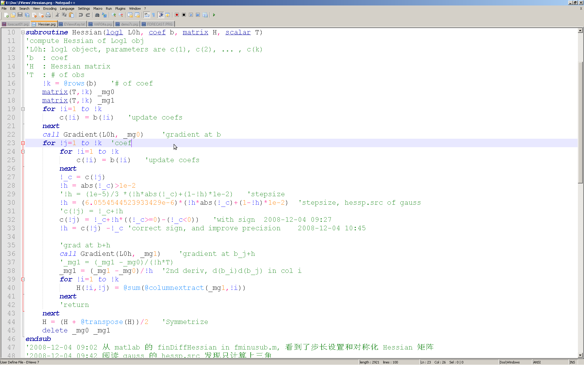

Postby maxchen » Sat Nov 24, 2012 5:06 am
syntax highlighting
Line numbering
Highlight the current parenthesis level when editing (useful when nested).
Highlight the current line
Collapse blocks, such as IF, FOR, WHILE or subroutines blocks
the configure file
EViews7.xml.7z
User Defined Language File
(2.47 KiB) Downloaded 1570 times

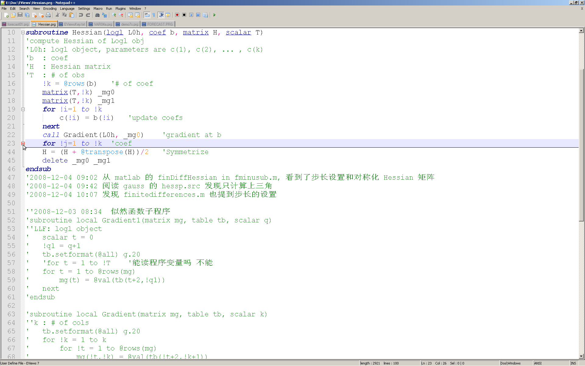

some screen shot
screen shot
Collapse blocks
Collapse "FOR" block
The screen short are from notepad++ 6.2.2, http://download.tuxfamily.org/notepadpl ... imalist.7z
Or you can find one custom-made by me: http://forums.eviews.com/viewtopic.php?f=5&t=7098
one issue to resolve: see the line 36 or 38, the number is part of the name of variable, but highlight as a number

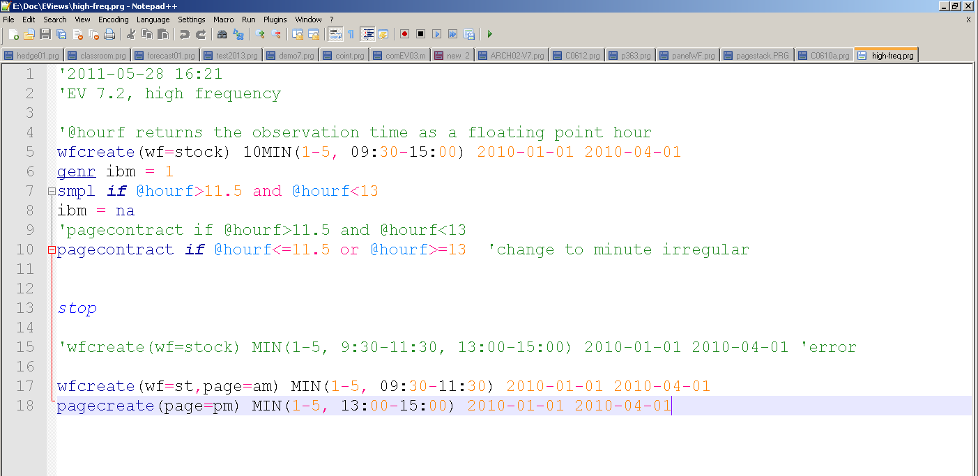

there is one annoying bug: identify the " if condition" as "if block"
screenshot
cond if.png (31.42 KiB) Viewed 32545 times

Postby maxchen » Sat Jun 29, 2013 6:15 am
The semisolution would be to define closing "Folding in comment" keyword, see
https://sourceforge.net/p/notepad-plus/ ... /56132212/

Postby paues » Tue Aug 06, 2013 12:40 am
One potential solution would be to have "then" be the trigger word for if statements rather than "if".

Postby maxchen » Tue Sep 10, 2013 5:29 pm
thanks, great!
