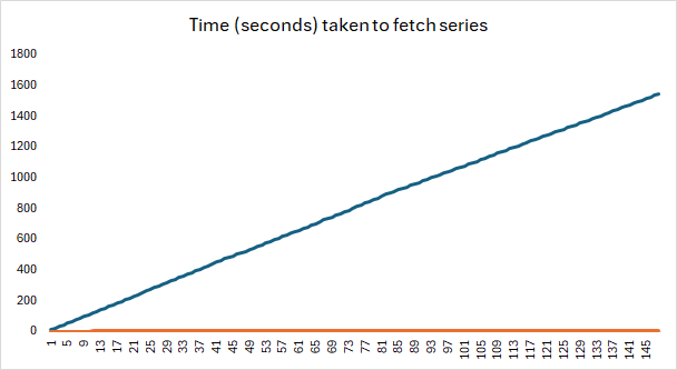

But, at the moment, its usefulness is severely limited by the fact that it takes a very long time for me to fetch data from it. I will share some details below about that.
mode quiet %data = "INSERT SERIES HERE (SUPPRESSED)" tic table clock !n = 1 For %1 {%data} fetch(db=statcan) {%1} clock(!n,1) = !n clock(!n,2) = @toc !n = !n+1 Next delete df* 'Fetch a second time: tic table clock2 !n = 1 For %1 {%data} fetch(db=statcan) {%1} clock2(!n,1) = !n clock2(!n,2) = @toc !n = !n+1 Next
In this example, I fetched 148 series and it took 26 minutes!
What's interesting is that once the data is fetched, fetching it again shortly after time takes very little time (6.4 seconds).
Is this normal? Is there anything that could be done?

Its probably just a really large download that StatCan is sending. The reason it is fast the second is that we cache it.

Thanks for the quick response. I understand it may be a very large download, but if there's anything that can be done to make it smaller (or download faster) in the future, that would make the feature much more helpful.
For example, in my case, all these series were being downloaded from the very same table. So, it seems like if an entire table is being downloaded, it's being downloaded repeatedly and unnecessarily? Maybe something to look into....
