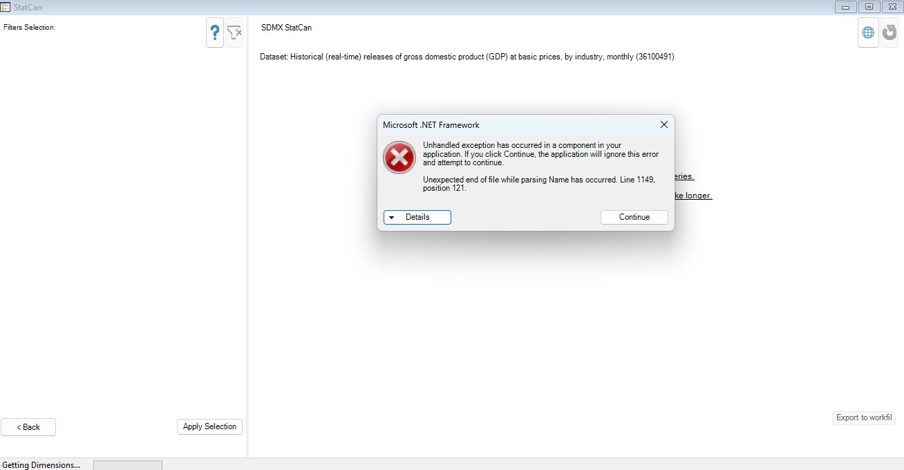

Postby random_user » Thu Aug 13, 2026 8:30 am
Hi again,
I'm now having some trouble fetching series from a specific Statistics Canada table. It's not clear if it's an issue on the Statistics Canada side or EViews. But what I can say is that most tables work but at least one does not:
For example:
FETCH(DB=STATCAN) DF_36100491__1.1.1.1.122
This is from table: Table: 36-10-0491-01.
Even when I just try to use the browser, I get the attached error
