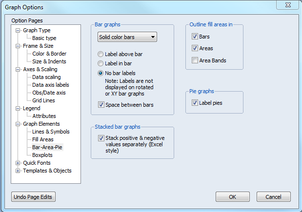

This is not a bug. The way EViews creates a stacked bar graph (i.e. stacking positive & negative values) is different from Excel.
You will get the desired result by choosing the checkbox of the Stacked bar graphs (Graph Elements -> Bar-Area-Pie -> Checkbox: Stacked bar graphs ) option.

Is there a way to do this by coding it? I'm trying to do a mixed graph with a line and the rest stack bars but the 'stackedbar(2,3,4)' command seems to default to the non-excel way.

Postby EViews Gareth » Fri May 13, 2022 8:55 am
mygraph.options stackposneg
