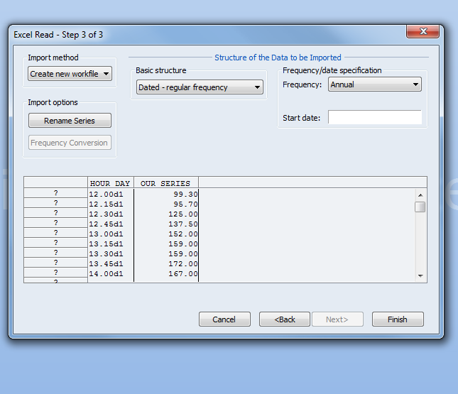

Re: Define the Range of data
This is the problem
I cant define my range !!

Try setting the frequency to intra-day.

Thanks a lot for your cooperation.
I tried to do by intraday, but I have the same promblem to define the Range, because I take my records for each 15 min.
There are another way in order to define my Data Range??
- Posts: 3798
Intraday allows for data at 15 minute intervals.
