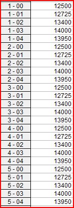

Postby Fabian2 » Tue Aug 27, 2013 2:48 am
See the screenshot for what I meant. A series dependent on year but not on firm number.
I figured out how to do it via links to other workfile pages.
