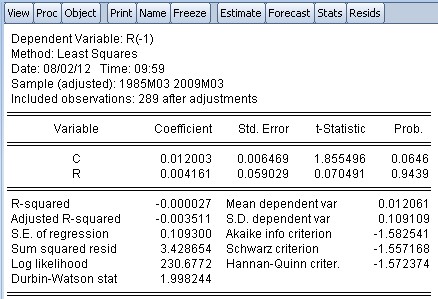

I have the problem that at the very basic OLS regression of a return variable against its first lag no F-statistic is reported! What can be the problem and how can I get the f statistic and probability. The regression looks like "r(-1) c r"

Postby gobbble » Thu Aug 02, 2012 1:01 am
here it comes. Regards
regression on r.jpg (54.24 KiB) Viewed 15192 times
Re: simple OLS regression- F-statistic is not reported
Postby startz » Thu Aug 02, 2012 6:09 am
Something's really, really wrong as you also have a negative R-sqr. I think you've hit a bug. The EViews folks are going to want to know the version and build date of your copy of EViews (Help/About).

Postby gobbble » Thu Aug 02, 2012 9:15 am
thanks. I have eviews 7 standard edition Jan 7 2010 build.
By the way, when I regress the other way around, everything turns out fine...
Postby startz » Thu Aug 02, 2012 9:17 am
You should probably push the update button, since your copy is more than two years out of date. If convenient, it would also be helpful if you posted your EViews workfile.

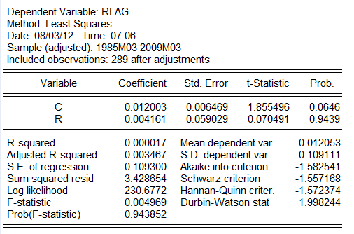

So that you can get on about your work, I have done the following.
series rlag=r(-1) ls rlag c r
I've posted the results for you, but I'm 99% certain that you want
ls r c rlag
instead.

Thanks for posting the workfile gobble. That helps a great deal.
That's a good suggestion startz and the one that I've used to verify the issue.
I'll have a fix posted shortly.
