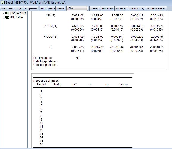

Further to this, in a quick test, using all the default settings, I do not find any output in the IRF tables. I have used MSBVAR as a standalone in the past without such problems. Has the porting to EViews somehow cleared these entries?
Regards
Donihue
Posts: 13610
Re: BVAR (Bayesian VAR)
Postby EViews Gareth » Mon Apr 12, 2010 11:36 am
Looks like something went wrong during the calculation of the BVAR - notice the log-likelihood is NA.
If you post your workfile, I'll see if I can figure out what is going on.
Although if you have some familiarity with MSBVAR, you might like to take a look yourself - if you go to the add-in folder for the BVAR add-in (probably "my documents\eviews addins\bvar") and then open up the bvar.prg program, and edit the first line so that it says !debug=1, then go to the bottom of the program and comment out the XCLOSE command, and save, when you run the Add-in, you should see the R Log open and see any errors that R reports.

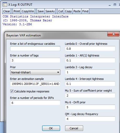

Postby donihue » Mon Apr 12, 2010 4:15 pm
Thanks very much Gareth.
Just tested the new version. Unfortunately, a similar sample problem arose - see photo below.
I also noticed that MSBVAR will work with nu >= m+1 (but not <) so perhaps an option for nu could still be left in, but coded so that it has to meet the >= m+1 condition
Regards
Donihue
Posts: 13610
Postby EViews Gareth » Mon Apr 12, 2010 5:37 pm
I'll contemplate Nu tomorrow.
I fixed a bug with the samples, but I'm not sure I follow your bug. That box simply gets filled out with the workfile sample when you run the add-in.
It might be that after a debugging run, or a run where R failed, the workfile sample is left in a bad state so that when you re-run the add-in, that box gets filled with junk.
