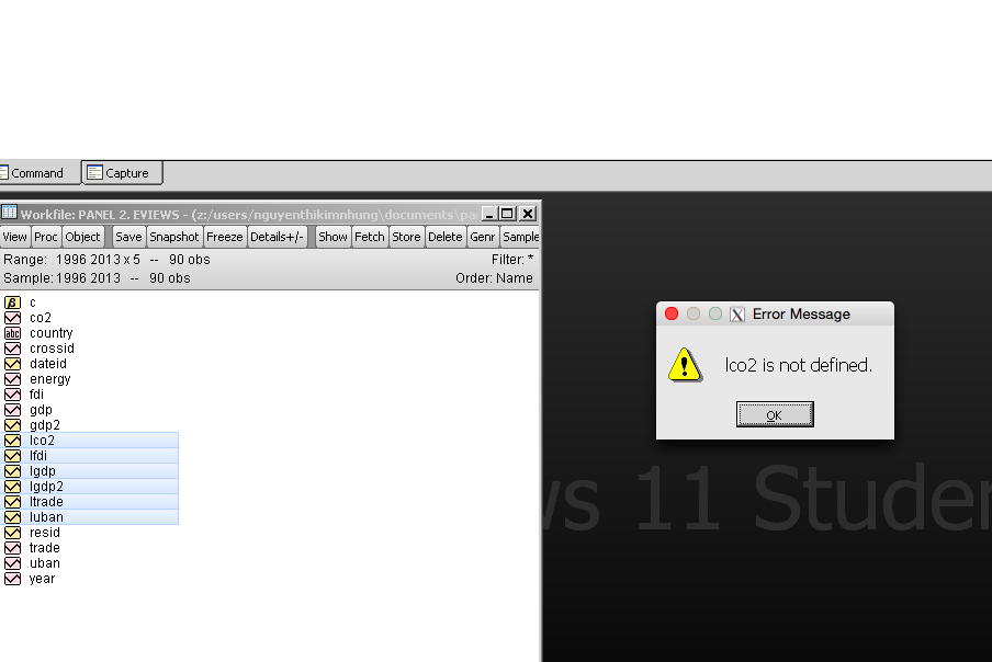

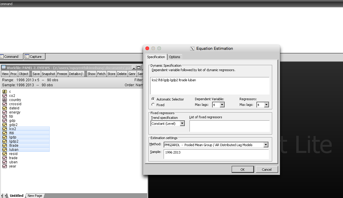

Here is screenshot
Screen Shot 2021-01-04 at 08.36.50.png (44.11 KiB) Viewed 14597 times
Screen Shot 2021-01-04 at 08.36.16.png (57.74 KiB) Viewed 14597 times

lco2 is not in the Excel spreadsheet you uploaded.

Thanks for replying. But I create the log variable in the eviews (as you can see in the post)
Re: Error "Variable is not defined" in panel ARDL
Postby startz » Tue Jan 05, 2021 8:10 pm
I see that it is in the picture, but I don't know how you created the variable. I also don't know how you created the other variables that are not in the Excel workfile.
Also, while it is very unlikely that you've hit a bug it is not impossible. It would help the EViews team if you told them the build date of your version.

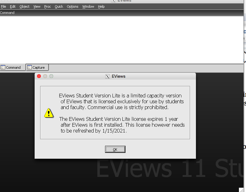

Thanks so much for replying startz. I transform variable into log form, the original is not in log form. That is why you dont see the log variable in the spreadsheet. I can not send you the workfile as i am using Eviews 11 student lite version (which has many limitations), which does not allow to save my file. Would you mind transforming my data to log form and run ARDL in your eviews to see if you have similar errors? I am using macbook, which causes me difficult to install eviews without buying it. I attached a picture of the eviews version . Hope to hear from you
Screen Shot 2021-01-06 at 11.07.59(2).png (42.05 KiB) Viewed 14541 times
