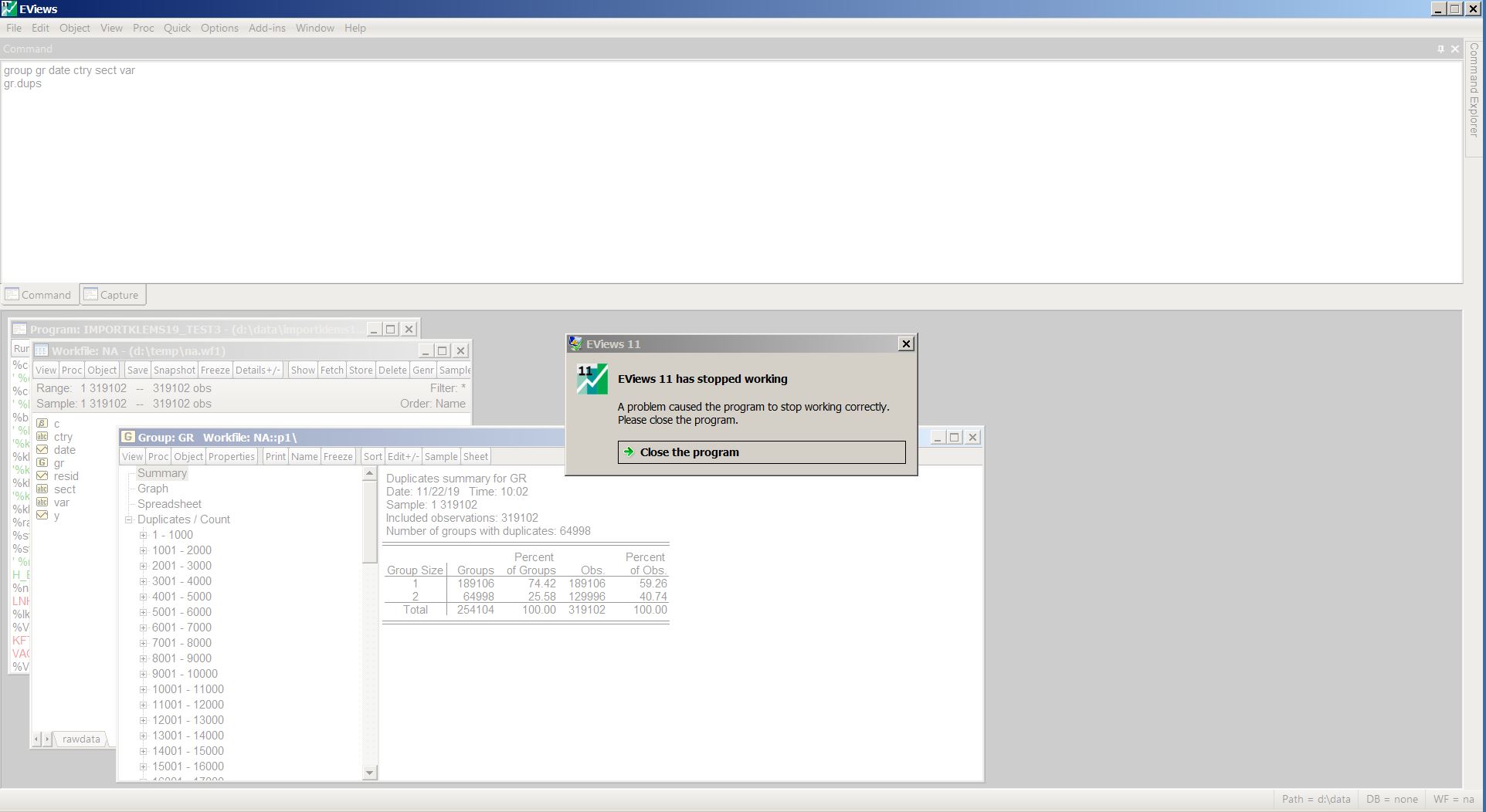

using Eviews 11, 17 Sept 2019 build, it seems that working with the duplicate view of a group lets EVEIWS crash, at least when working with a large data set.
See large data file "na.wf1", attached, and try "gr.dups", expand to "Duplicates/Count" and try to click one of the lines.
A scree-shot from EVEIWS crash is attached as "crash.jpg"

The crash comes when trying to click on of the items in the left-hand panel of the open duplicate menu, such as for instance, a line below "Duplicates/ count", or any item above that. Perhaps you may try to select items in order to replicate the crash.

Yep, see it now, thanks. We'll fix.
