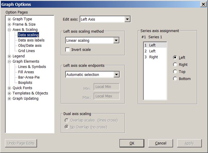

in a panel chart which has individual charts for each cross-section, it is not possible to make two vertical axes (left and right) overlapping manually, for all cross-sectional sub-charts at once, by using the menu "Options for all graphs" of the graph objects menus.
New Picture.jpg (57.16 KiB) Viewed 10068 times
Rather, one has to change the overlapping of axes for each sub-chart individually via "options for the selected".
This is cumbersome when the combined chart contains many sub-charts from a panel structure.
I found that it is possible to render axes of combined graphs showing individual panel graphs as overlapping in a program (see example program below).
This bug does not happen when graphing data which do not have a panel structure, or when panel data are shown in a stacked or a combined graph.
