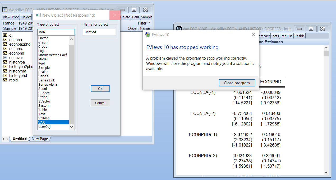

Postby startz » Mon Mar 05, 2018 12:47 pm
Killed it several times. At least twice I was able to do this by
1. open workfile
2. object/var/econvar
3. specify and estimate including @trend
4. object/var - blewey
screen shot and file attached
econ and history degrees.WF1
(18.69 KiB) Downloaded 526 times
Re: blewey
Postby EViews Steve » Tue Mar 06, 2018 7:31 am
What is the build date? Is this 32-bit or 64-bit?
Re: blewey
Postby startz » Tue Mar 06, 2018 9:14 am
February 26, 64-bit.

Re: blewey
Postby EViews Glenn » Tue Mar 06, 2018 1:55 pm
What's the VAR spec?
Re: blewey
Postby startz » Tue Mar 06, 2018 2:03 pm
Default for variable EconBA and EconPhD with addition of exogenous @trend.

Re: blewey
Postby EViews Glenn » Tue Mar 06, 2018 5:50 pm
You are having problem at estimation time? No problem here with "C @trend" and "@trend" alone.
Feb 26 64-bit
Re: blewey
Postby startz » Tue Mar 06, 2018 6:39 pm
No. The problem happened on trying to open a new object after the estimation. I have no reason to believe the estimation was relevant.

Re: blewey
Postby EViews Glenn » Tue Mar 06, 2018 6:49 pm
Do you get a "Delete Untitled VAR" prompt? What is your "Global Option/Environment/Allow only one untitled" setting? (Still can't replicate).

Re: blewey
Postby startz » Tue Mar 06, 2018 7:11 pm
No prompt, and I believe it happened before I closed the dialog.
