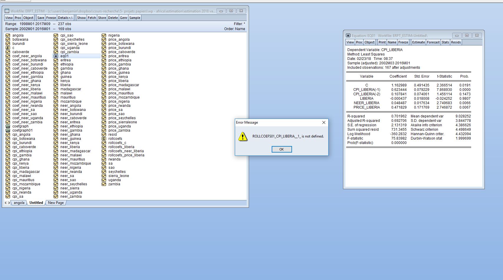

Im trying to run a roll regression from the existing object eq01 (object roll01) but Im getting a message error (see the attached files).
The message is : _RSES02_NEER_SEYCHELLES01 is not defined.
Are there any solutions ?

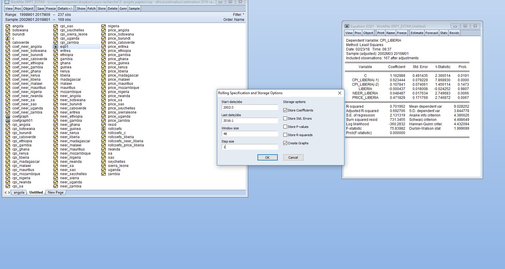

I added the add-in, runned an ols model and saved the object (see eq01), created a new object "roll" and selected the equation object for the rolling regression (fixed window ; step size1 ; window size = 47; start and last dates are the sames as the sample).
I didnt get the message for almost all models (cpi_xx c neer_xx price_xx), but for some countries, the neer_xx variable seems to get the estimation to crash although the variables seems fully normal.
Im getting the same message whatever I use an existing object or an equation entered manually.

It sounds like you're using the roll user object, not the rolling regression add-in? You might be better off using the add-in.
