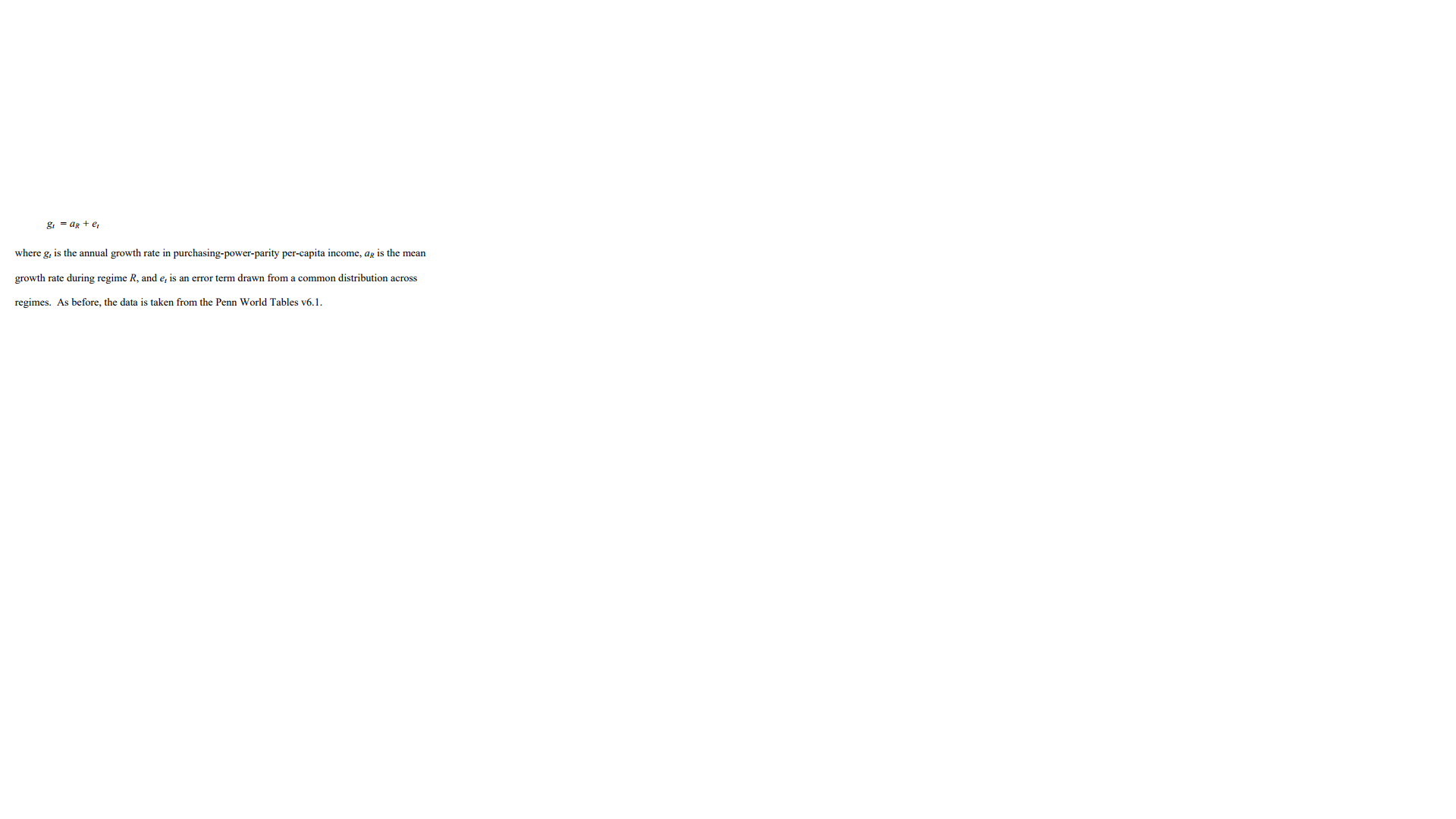

The paper identifies the structural breaks in countries growth rates and then looks at the factors associated with them. The structural breaks are identified from this equation:

Postby hello1994 » Wed Sep 27, 2017 3:11 pm
The equation in the image is:
gt = aR + et where gt is the annual growth rate in purchasing-power-parity per-capita income, aR is the mean growth rate during regime R, and et is an error term drawn from a common distribution across regimes. As before, the data is taken from the Penn World Tables v6.1.
