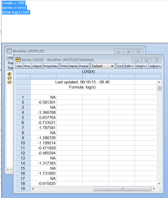

create u 100 series x=nrnd show log(x).hist
In interactive mode gives me the (correct) alert and then shows a spreadsheet rather than a histogram 100 percent of the time.

What setting do you have for auto-series evaluation on your latest version of EViews:
Options/General Options/Series and Alphas/Auto-series

Report evaluation errors. I assume that's the default?
Re: log bug, or at least ungoodness
Postby EViews Gareth » Tue Jun 16, 2015 10:27 am
No.
Postby startz » Tue Jun 16, 2015 10:33 am
Well, that explains the different behavior.
Since NAs get generated properly either way, it would be nice if the alert were followed by the hist view rather than the spreadsheet view. Since the spreadsheet view is the default, I suppose that might be a pain. It's certainly not too important.
