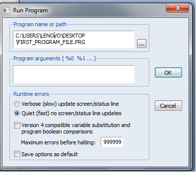

In order to replicate the error set default options:
1. Quiet (fast) no screen update
2. Maximum errors before halting 9999999
Re: Eviews crashes in subroutine
Postby EViews Gareth » Mon Mar 23, 2015 9:47 am
Ha, the maximum error count is what did it. We'll investigate. In the meantime, setting errors to 1 will cause it to not crash.
