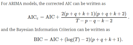

I meant the alternate AIC for ARIMA processes. I believe it is a useful supplement to eviews view ARMA structure feature, when determining ARIMA orders.
The exact criterion would be:
I wasn't sure if either of these were built in, or if there was a line of code to view it in a scalar.
One could crunch the numbers manually without too much trouble, but while one modifies a model, the p's, q's and k's could be different every time, computing this by hand has some efficiency drawbacks.

No, that correction is not made, although when calculating the standard AIC and BIC, p and q are included in k.
