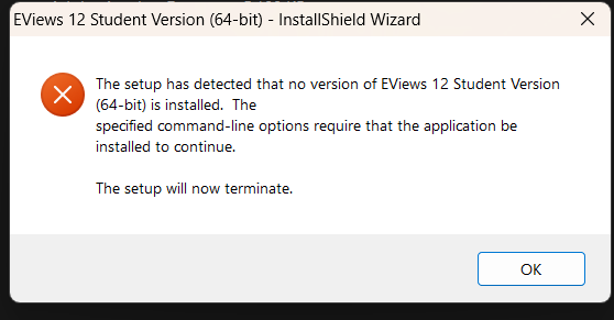

I am trying to install Eviews 12SV but I keep getting below error.
Screenshot (59).png (17.13 KiB) Viewed 55873 times

It looks like you're running the patch installer, rather than the full application installer.

Hello, i downloaded it from the link sent by you guys along with the serial number. I am pretty sure that it's not the patch installer but if it really is a patch installer, could you please direct me to the full application installer?

The 12 SV installer is getting confused by a previous failed installation. You'll need to clear some settings in your Windows registry before you can re-run the installer.
Here's the REG zip file. Download and extract the REG file, then double-click it to run. Proceed thru any security warnings and allow it to make changes to your registry. Once complete, re-run the 12 SV installer and it should work this time.

It worked! Thank you!!
