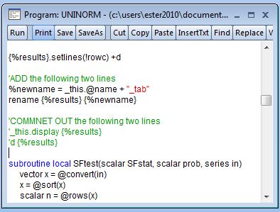

Postby EViews Esther » Tue Apr 24, 2012 1:32 pm
Let me introduce one ad hoc approach. After editing the program, UNIFORM.prg (please see the attachment), you can run the following codes:
group g ser1 ser2 ser3 for !i=1 to g.@count %sername = g.@seriesname(!i) series {%sername} {%sername}.uninorm next next
Please note this is an ad hoc approach.

hello
I want to store the values ​​"Statistic" and "Prob" of Shapiro-Wilk Test in tow variables (with run Normtest add ins). How should I do this programmatically? thank you

Posts: 13609
Re: Normtest
Postby EViews Gareth » Thu Jan 25, 2024 4:13 pm
Probably best off just modifying the source code of the add-in to store whatever you want stored. In effect creating your own version tailored to do what you want it to do.
