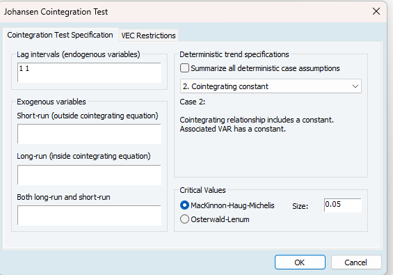

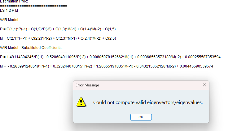

I have experienced an issue computing the Johansen cointegration test in EViews 13.
When using Model 2 (Cointegrating constant), I got the message “Could not compute valid eigenvectors/eigenvalues”.
I guess there is a bug code in EViews 13 because I can run the cointegration test (using Model 2) in previous versions of EViews without a problem. Furthermore, I can estimate a VECM using Model 2 in EViews 13, making me think about a bug code.
Additionally, I have experienced this problem with different datasets.
Can someone help me with this issue?
Thanks!

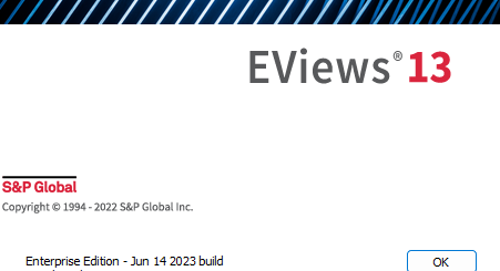

What's the build date of your copy of EViews 13? (Help->About EViews).

Postby lesalaza » Wed Jun 28, 2023 6:30 am
It says Jun 14 2023 build.

In the workfile qtm.wf1 you can find VARMONEY. If I try to run the Johansen cointegration test using Lags intervals 1 1 and Model 2 (Cointegrating constant), I get the message "Could not compute valid eigenvectors/eigenvalues".
Thanks for your help!

The most recent patch should fix this issue.

It is now working!
