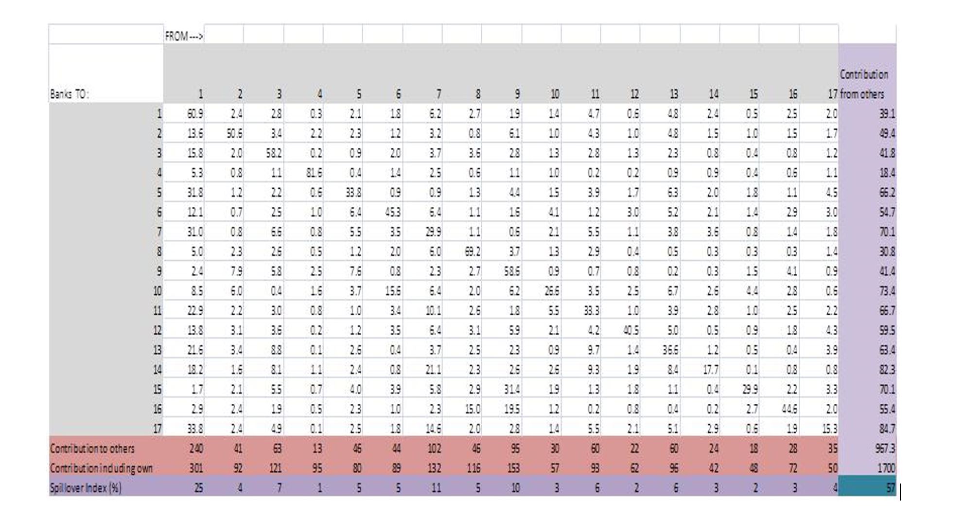

Thanks. To clarify, some of my columns are >100 in tovar, so I'm trying to figure out how to interpret this (as it can't be the percent share). Do I need to take another step, so column 1/divided sum of columns, would be the outward spillover index for that variable?
To be very specific, does the 'tovar' metric correspond to the row "contribution to others" in the attached matrix (on a rolling basis of course)?
