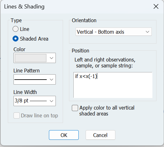

I was wondering if there is a way to tell EViews to shade a graph whenever the variable is decreasing.

When you add shading to a graph, you can specify a sample string, which could be an if condition such as:
if x<x(-1)

Thank you very much!
