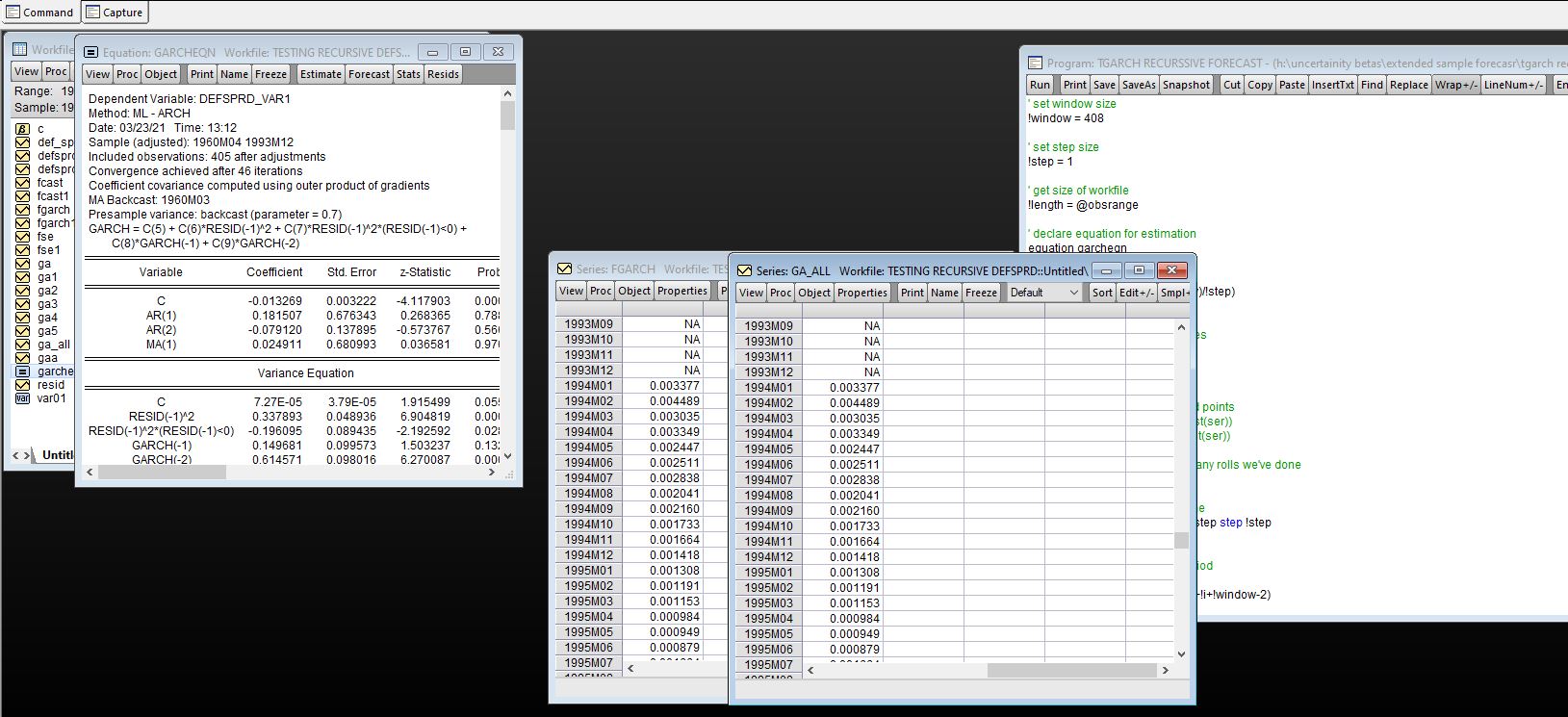

I am using the same model and extending dates to estimate it. please see the below screen for your referrence. ga1, ga2, ga3 are the garch forecast from the model.
ga1 (estimation period 1960m01 - 1993m12 - forecast period 1994m01 1994m01)
ga2 (estimation period 1960m01 - 1994m01 - forecast period 1994m02 1994m02)
ga3 (estimation period 1960m01 - 1994m02 - forecast period 1994m03 1994m03)
Regards,
Sara
Eviews file.JPG (195.7 KiB) Viewed 8847 times

Re: In-Sample one step ahead recursive volatility forecasting via TGARCH
Postby EViews Gareth » Tue Mar 23, 2021 3:02 pm
Nothing immediately jumps out from looking at your code.
