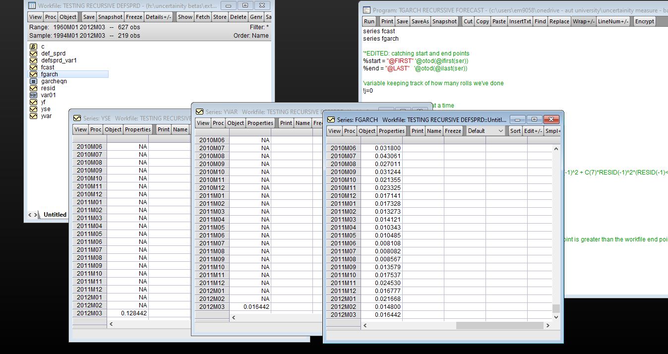

I can see results for my forecast in the Garch Series but yf, yvar & yse - they all are NA except for the last value. I am not sure why? although I can see all values which I forecasted in the fgarch series.

Please see the image of my results

yf, yvar & yse are all temporary, discardable series. Ignore them.

ok got it - I added these in d(noerr) line and now see the series only in my output file.

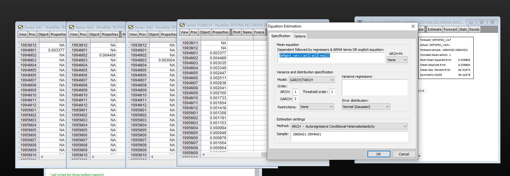

I am facing a problem when I try to match the forecasted results obtained from this code and forecasted results obtained from the model (see attached screen).
it seems the code is not rolling ahead of one month to forecast the next value at every step and it remains static 1960M01-1993M12 and forecast the values.
I can see the same results when I use the static forecast based on my sample 1960M01-1993M12 via the model.
Am I doing anything wrong here? selection of window size or length - I am quite confused about what should I edit to make it roll one month ahead and then it forecast and then continuously adding months to do the forecasting?

Hello Gareth,
Please can you advise further on my post 7? I would really appreciate your help on this.
I checked the code estimation step manually and can see it is adding one month and I also checked the forecasting step that shows the forecast for each month from 1994M01 -2012M03. so I am not sure what I am doing wrong to match my forecast with the model just to verify the forecast results.
I am using the same model and extending dates to estimate it. please see the below screen for your referrence. ga1, ga2, ga3 are the garch forecast from the model.
ga1 (estimation period 1960m01 - 1993m12 - forecast period 1994m01 1994m01)
ga2 (estimation period 1960m01 - 1994m01 - forecast period 1994m02 1994m02)
ga3 (estimation period 1960m01 - 1994m02 - forecast period 1994m03 1994m03)

Hello there,
I tried to test the forecast results with my model and extend the sample by one month and getting a different forecast value as compared to the one obtained from the code.
I have attached my workfile already with the model and need help.
I would appreciate it if someone can point out the problem/mistake I am doing to get this extended sample forecast?
