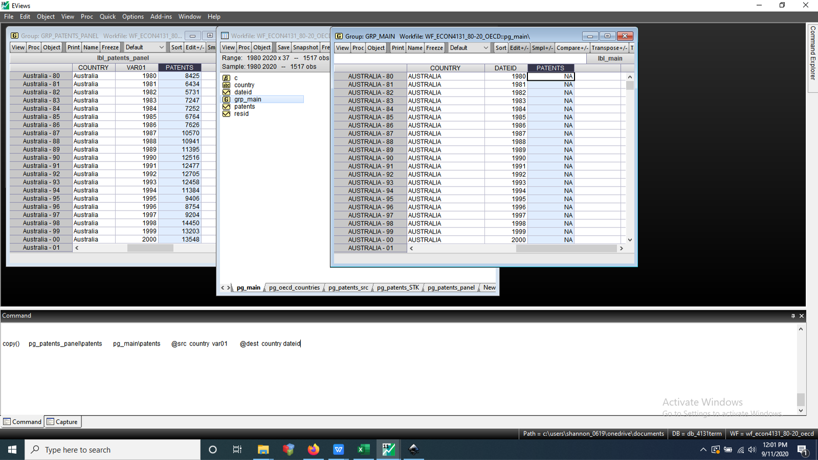

I am attempting a copy() between two pages ... I believe the problem is case sensitivity between the @src and @dest ... I tried
copy() ... ... @src @upper(country) ...
where 'country' is the source series with lowercase, but of course upper() is not intended to work on a series ...
copy() pg_patents_panel\patents pg_main\patents @src country var01 @dest country dateid
Is there a way to handle the case issue using copy()?

You can use @upper on a (alpha) series, but you cannot use it inline in the copy command.
Create a new alpha that is equal to @upper(country), then use the new alpha as the source id
