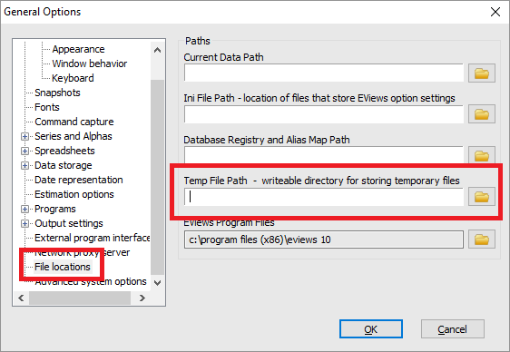

Postby EViews Steve » Thu Apr 23, 2020 9:00 pm
Make sure your Temp File Path is pointing to a valid writable directory. To see this value, go to Options menu, General Options, File Locations.
Also, specifically for X11, X12, & X13, make sure that your working directory is not more than 4 folders deep (the X?? programs we use do not support a working path that has more than 4 folder names).
For example, a working path such as:
c:\Temp
or
c:\Temp\Folder2\Folder3\Folder4
is ok, but:
c:\Temp\Folder2\Folder3\Folder4\Folder5
is not.
Our default working folder is:
C:\Users\<username>\AppData\ev_temp
where <username> is replaced with your actual Windows username.

Thanks. My Temp File Path has 6 folder names. Can I assign a new directory for any folder, say, a desktop folder?
