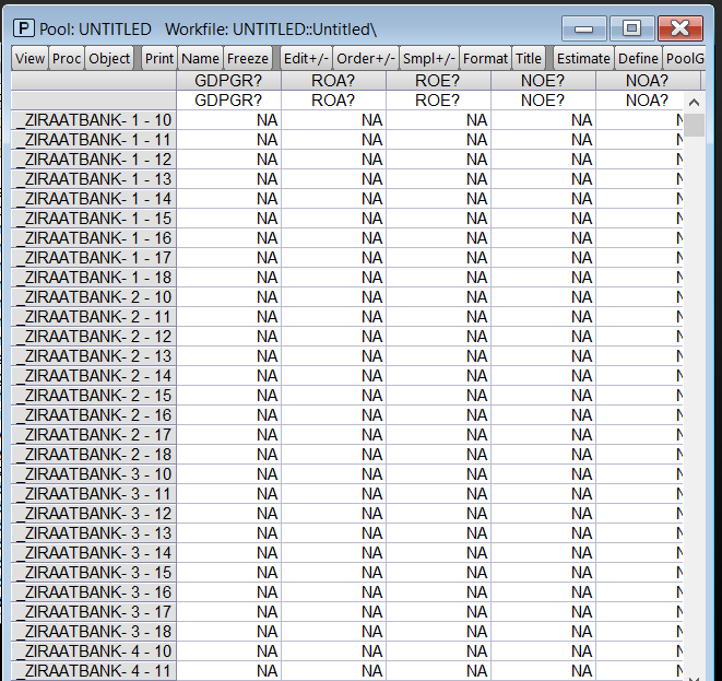

Hello everyone,
I have got a final year project. And my project about "effects of digital banking on Banking performance in Turkey between 2010-2018" and I collected data and wrote my datas to excel. And after I want to compare those data with Eviews Panel-data method. But when I want to calculate those datas I'm getting error from Eviews. First one is "N/A" error so I do not see my datas. And second one is "insufficient number of observations" error.
Can somebody help me?
Panel Data.xlsx
(13.49 KiB) Downloaded 427 times
Re: N/A and insufficient number of observations errors
Postby startz » Tue May 28, 2019 5:14 pm
Looks like something went wrong on getting your data into EViews.
Postby startz » Wed May 29, 2019 5:44 am
I dropped your Excel file onto EViews and the data came in fine. Perhaps you can tell us exactly what you did, in detail.
Postby bekiro » Wed May 29, 2019 6:34 am
I deleted the name of banks in my excel document. And after I opened it with eviews and my problem was solved. I wrote banks name with "_" Like "_ZIRAATBANK". Thank you for your interest.
