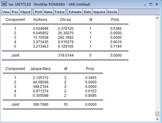

The Normality Test shows me if the residual VAR has a normal distribution (at 0.05). The prob. is 0.0000. What can I do in this case?

My question is why are you concerned about non-normality?

Because as I know this is one from the other tests that show me that VAR is ok. Doesn't it show us a VAR characteristic? What I want to do is to represent the impulse response function of 6 variable and I want to assure that VAR is correct represented.

Normality is of almost no importance for estimating an impulse response function. Sometimes people transform variables, for example taking logs, to get more normal residuals. But then of course you have to translate the transformed impulse response function back to the variable you actually care about.

Is there any way to solve this problem?

(1) You haven't said what the problem is. Non-normality does not invalidate a VAR.
(2) Sometimes you can take logs or make other transformations of the data to make residuals more normal.

I log data and after that I applied the first difference, but this didn't help. What other transformation should I do to test the normal distribution? This is for a project so I have to show it.

Perhaps you should ask your instructor why normality matters in this application.
After all, lots of things just aren't normal.
