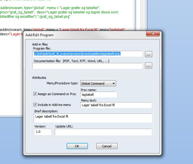

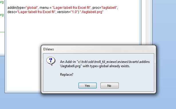

Postby tvonbrasch » Tue Sep 27, 2016 10:26 pm
when I install an addin using the command
addin(type="global", menu = "Lager tabell fra Excel fil", proc="lagtabell", desc="Lager tabell fra Excel fil", version="1.0") "./lagtabell.prg"
i get a warning that the addin is already installed.
However, if I add the nowarn option and use the command
addin(nowarn, type="global", menu = "Lager tabell fra Excel fil", proc="lagtabell", desc="Lager tabell fra Excel fil", version="1.0") "./lagtabell.prg"
i get the option
and nothing happens if I press OK.
Why is this?
