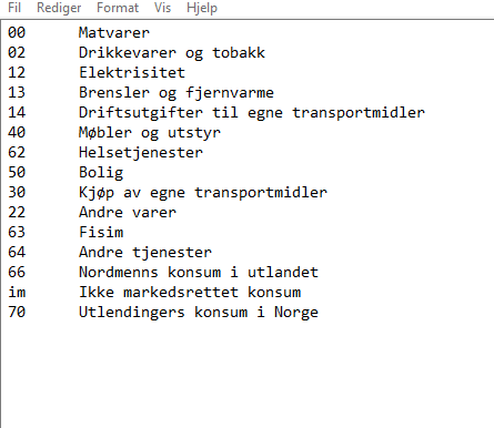

I want to import a text file into a table object using the command
importtbl(text,name=table) xxx.txt
However, the text for
02
is imported as
2
and
im
as
NA
(see picture below). How can this be imported direcly as a text string?
