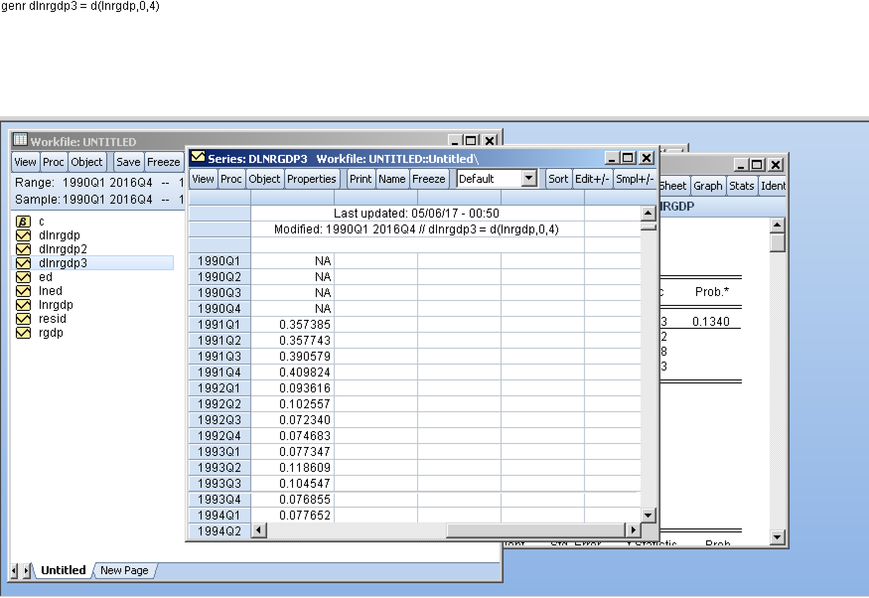

Posts: 13608
Re: 1st Difference
Postby EViews Gareth » Fri May 05, 2017 9:48 am
show d(y,0,4)
joannetan92
Posts: 8
Joined: Fri May 05, 2017 7:41 am
Re: 1st Difference
Postby joannetan92 » Fri May 05, 2017 9:52 am
Screen Shot 2017-05-06 at 12.51.26 AM.png (147.32 KiB) Viewed 15957 times

Posts: 13608
Re: 1st Difference
Postby EViews Gareth » Fri May 05, 2017 10:00 am
If you like.
