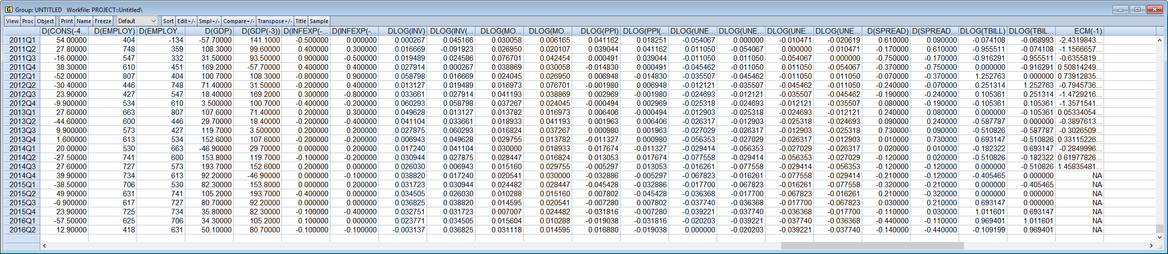

I have a problem in forecasting with my dynamic model (dyn_fin) in the workfile. I have estimated my model with the dataset from 1978q1 to 2014q2 and now I want to estimate the "virtual future" from 2014q3 to 2016q2 for the variable PCI. When I try to do this I get only one point of forecast due to the adjustment of the sample (static and dynamic forecast as well). I can't understand why there is an adjustment because I don't have any missing data and with another similar workfile I do not have this problem.

You don't have data for all of your regressors over the forecast period.

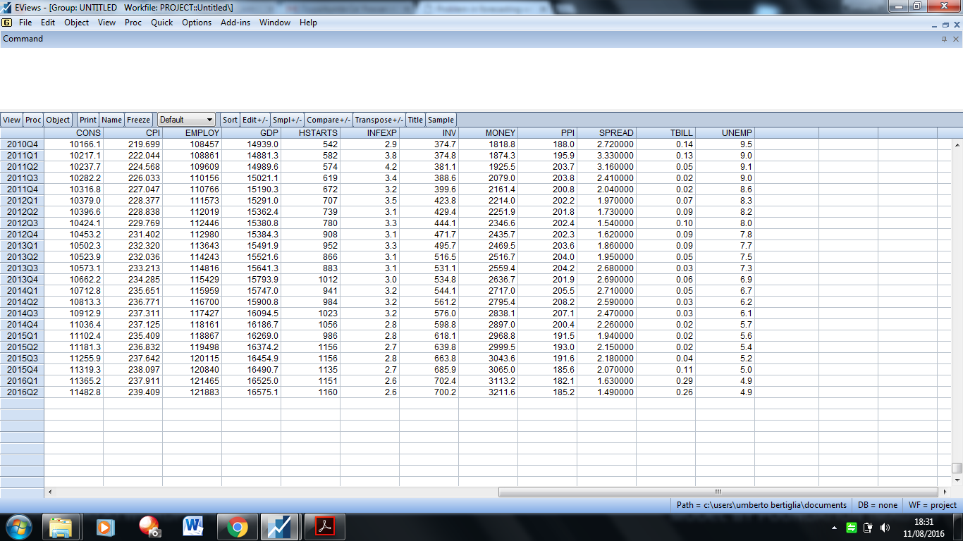

No, this is not true. My dataset is complete until 2016q2.
Look at the attached screenshot.

Looks at the regressors.

I have checked each regressor and for each series I have the data until 2016q2 so this cannot be the problem. There are not any missing data in the whole series.

OK...but in order to have the the missing data, I have to make a regression. If I made the regression, the forecast would be useless. This restriction on EView for what concerns forecasting makes the application totally useless...if you have the data, why forecasting?
Re: Problem in forecasting with dynamic model
Postby startz » Wed Aug 24, 2016 6:02 am
This has nothing to do with EViews. It is a fundamental issue with forecasting. You either need a model in which you know the future value of the right hand side variables or you need to build an auxiliary model to forecast those right hand side variables.
