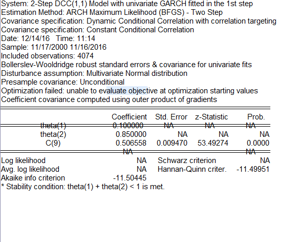

Re: DCCGARCH11
I am using Eviews 9 and I keep getting this result "Optimization failed: unable to evaluate objective at optimization starting values." and my rhos are all "NA."
Could you please help?
