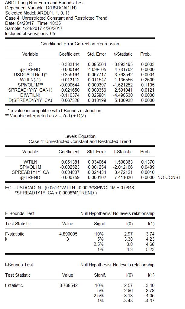

I just realized that in the context of ARDL estimation, the EC obtained in Proc->Make Cointegrating ... uses a trend initiated to the beginning of the range (and not to the beginning of the sample, as I was expecting). See excel file attached.
I understand that one can specify @trend with the date where one would like to start, but what to do in the context of cointegration estimation where one chooses to use the specification with trend?

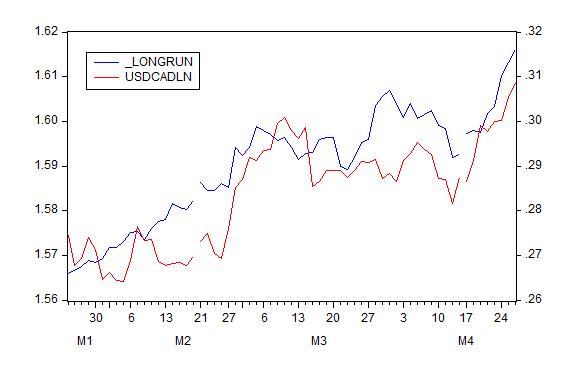

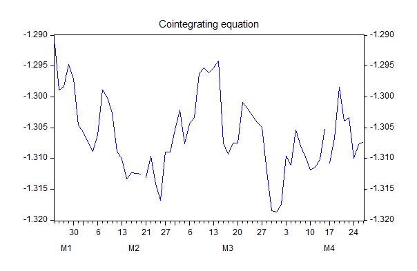

Here's the problem I'm having, and the reason I started suspecting the trend issue.
I'm running ARDL estimation (including a linear trend) where I'm mostly interested in the long-run relationship.
I obtained the "Cointegration graph", but the scale do not make sense (it's way too big): To double check, I got the "long-run" equation by running: long-run = dependent variable - cointeq
The implicit long-run is way off the scale of the dependent variable: So, my suspicions are with the trend because when I run estimations using the full range, the scale of the "Cointegration graph" makes much more sense (-2% to 12%).
Unless the issue could be related to the fact that the constant disappears from the "levels equation": Many thanks for your attention.
