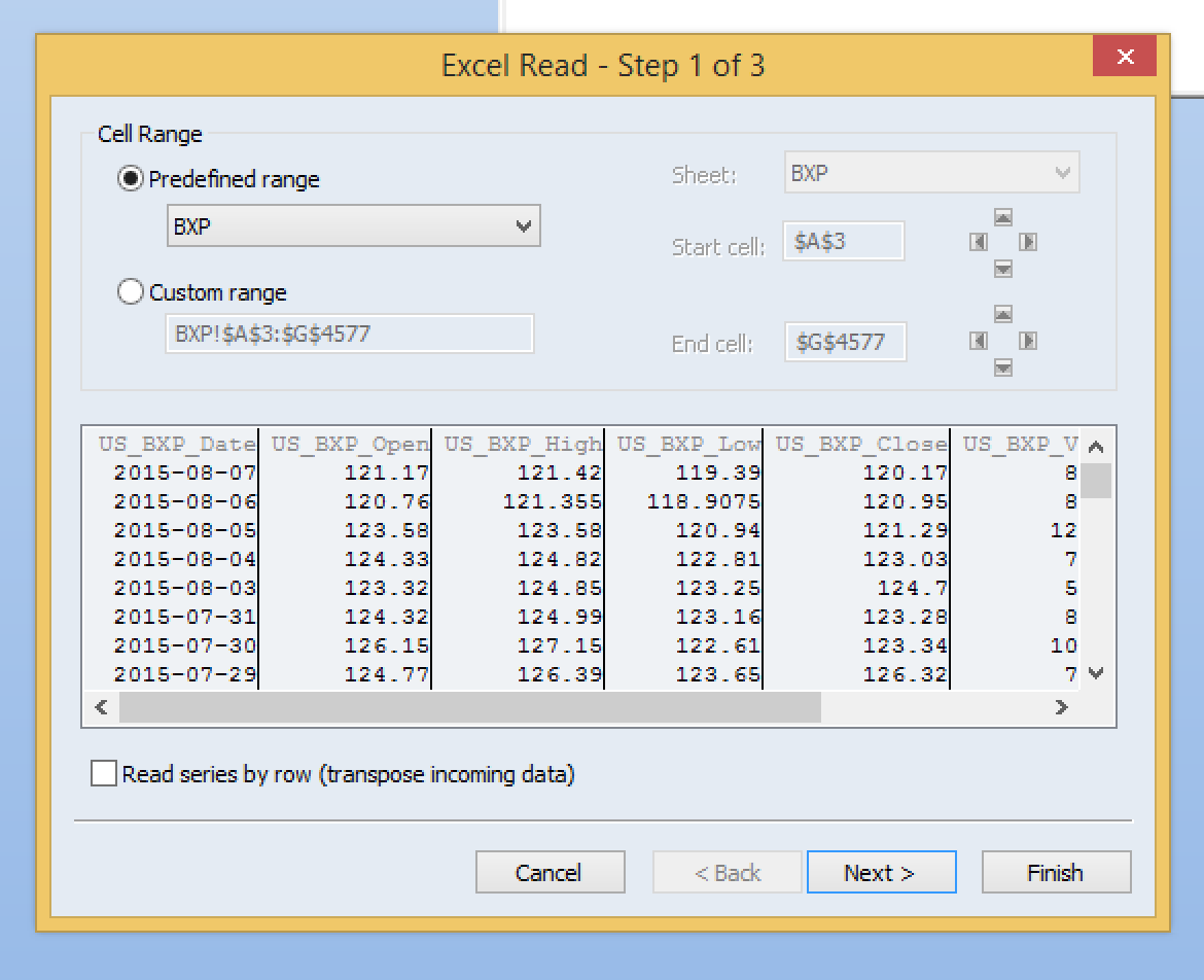

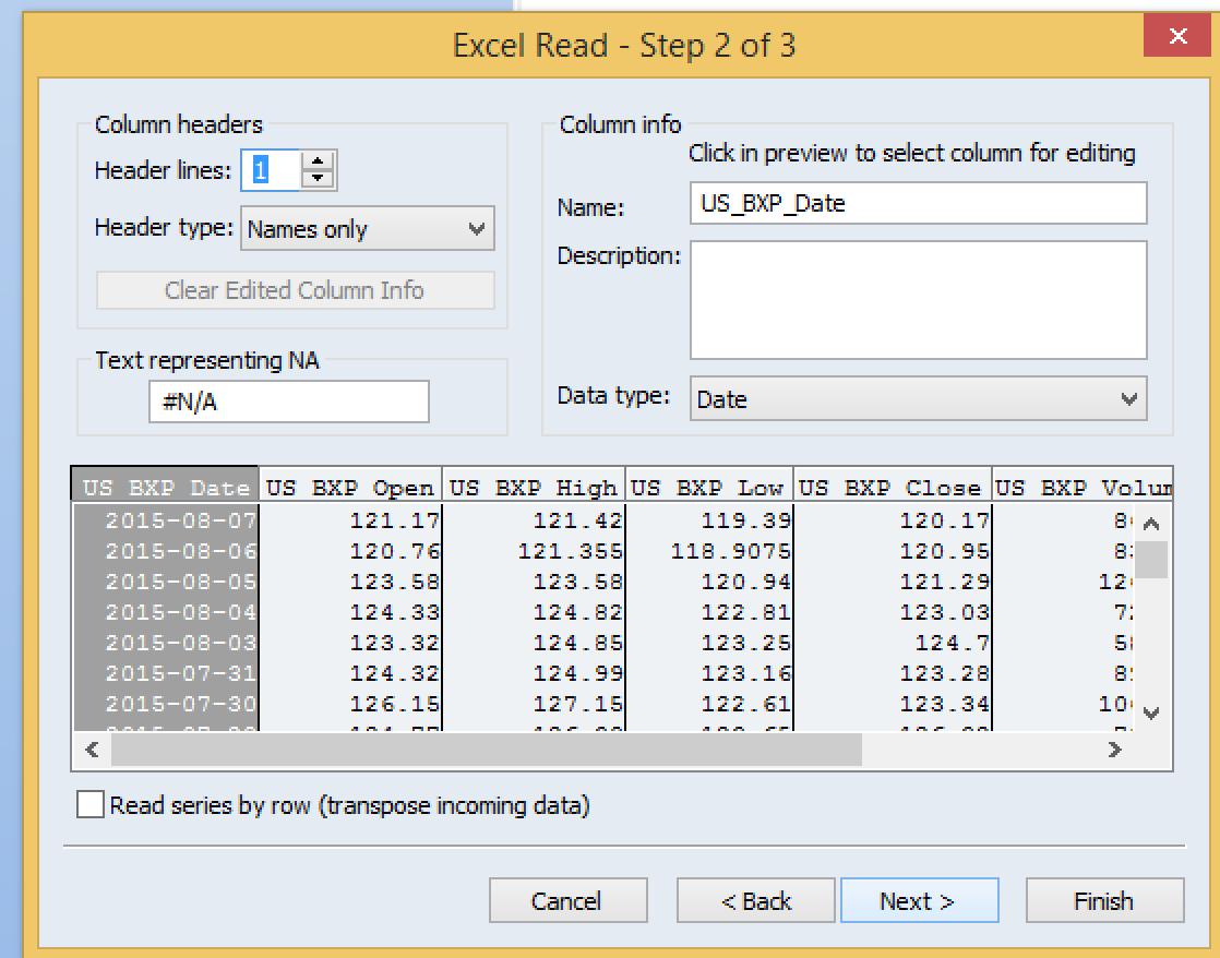

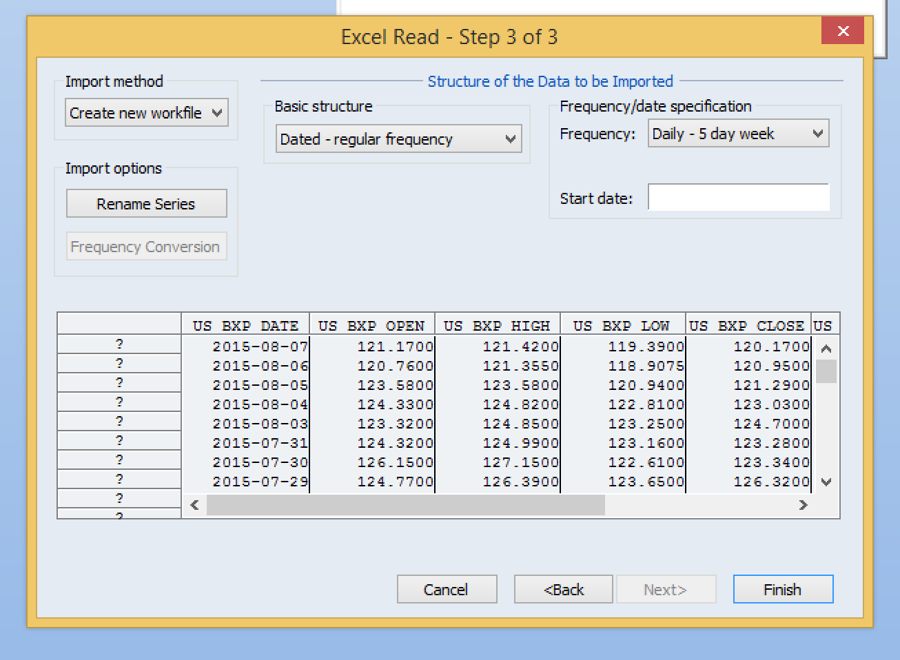

Please, see the screen shots attached. I selected to open a foreign data as workfile, it opened the data series, but it did not recognize the date column as dates and I cannot open the file as a data series only as a unstructured data.

SORRY I MISSED THE LAST ONE THAT SHOWED WHAT I MEANT

That file doesn't contain a valid date series. If the Excel file doesn't contain a valid date series, EViews won't be able to select a date series.

I found the mistake ! This data series came from Wiki and comparing to Yahoo's one there is some dates missing...I downloaded again and the series came again with the missing dates..tks

Generally if EViews refuses to auto-recognize a date series it is because there is something wrong with that date series

Postby fmantessof » Sun Aug 16, 2015 5:15 am
Gareth, I found out what is going on...I use Quandl to download the data in Excel, however Quandl is delivering the dataset with missing dates both through Google and Yahoo
