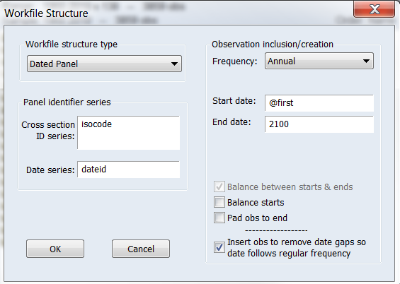

I have a dated panel with 138 cross-sections from 1960 through 2010. I want to extend the sample to 2100 for forecasting. I double-clicked on Range, got the Workfile structure dialog, entered 2100 for the end date, and hit Okay.
Nothing happened other than the dialog closing. I suspect I'm going about this in completely the wrong way.

Postby EViews Gareth » Thu Jul 09, 2015 9:25 am
Do the same thing, but this time check the box that says "pad obs".

Postby startz » Thu Jul 09, 2015 9:30 am
Nope. Well, either "nope" or I'm still not getting it.

Postby EViews Gareth » Thu Jul 09, 2015 9:34 am
Guess I should be more precise. Check the box that says "Pad obs to end".
