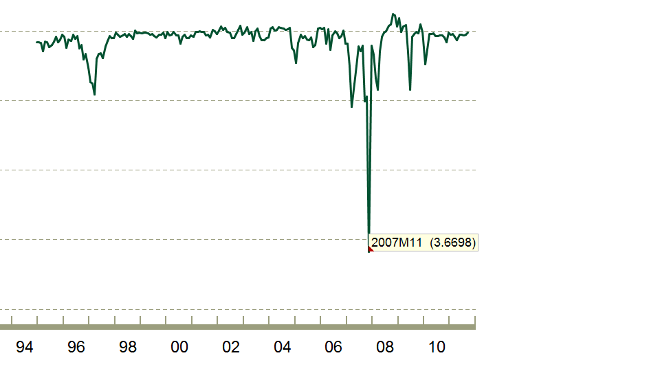

I am trying to use the above finds to do something on my chart.
Now I can have a dot with text next to it. My idea is: suppose I plot a series as a line graph.
What I want is to have text showing the last data point in my graph such as (2001m1, 123.45). My initial solution is to graph a
dot plot of only the last observation (by creating a new series that has only one observation), and then plot a line of the opriginal series
in the same graph.
The problem is: eviews doesn't allow dot to be the type of the first series in a "mixed lines" graph. It can only be area or bar.
Is there a way I can achieve that?
(I attached a photo of what I wish, however this is by placing the cursor next to the observation rather than generate a real text box by command).
Many thanks.

Re: How to assign labels to observations in a scatter plot?
Don't think it can be done.
- Posts: 2682
You can freeze and add the text label manually, but there's nothing automatic.
yes addtext another way I was thinking. and that leads to another thing.
as you know, graph.addtext(x,y,textcolor) is the command to locate the text box coordinates.
I just wonder if there is a way to let the program to return the coordinates of a certain data point?
for example, for an observation of (123.45,2001q1), is there a way to return the coordinate of this datapoint from the
graph?
graph?
No, which is why it impossible to add the text automatically.
