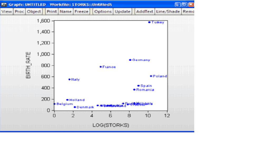

I found a chart on eviews help-> basic customization. The "lines and symbols " section gave an exact type of graph
I need, (Matthews(2000) data and storks.wf1). It shows how to do it by clicking but not by commanding.
I changed the project to be the graph name rather than the group name. this time there is no error.
But still it doesn't have the country name next to the points. I guess right now the scatpair can not
build any connection between the graph and the third alpha series "country".

- example.png (34.3 KiB) Viewed 13435 times
