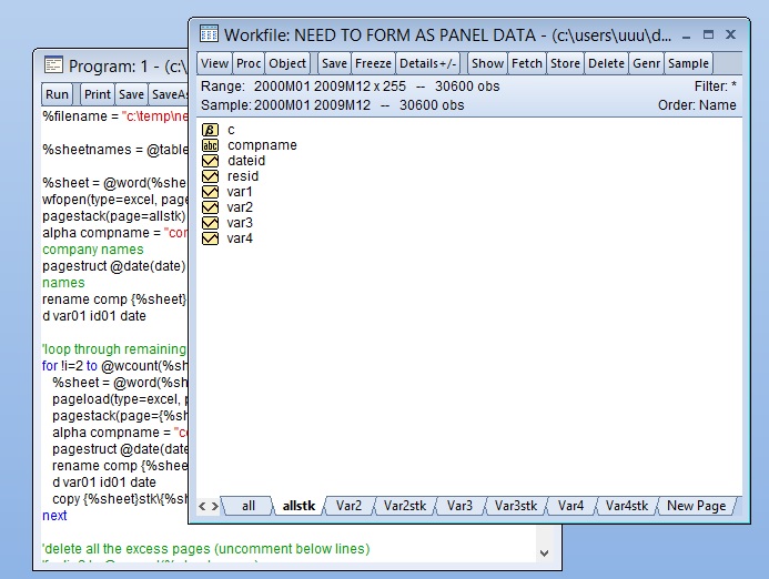

Thank you Gareth for your fast reply.
Since I'm newbie, and to confirm with you, I save your code into a prg file and run it from file>Run>Run Program without any arguments.
Eviews successfully imported data.
One last thing, later on I need to add maybe 3 to 4 extra variables to the existing variables. So, can I add them to the excel file and run the same code you've just sent me to import them too?
