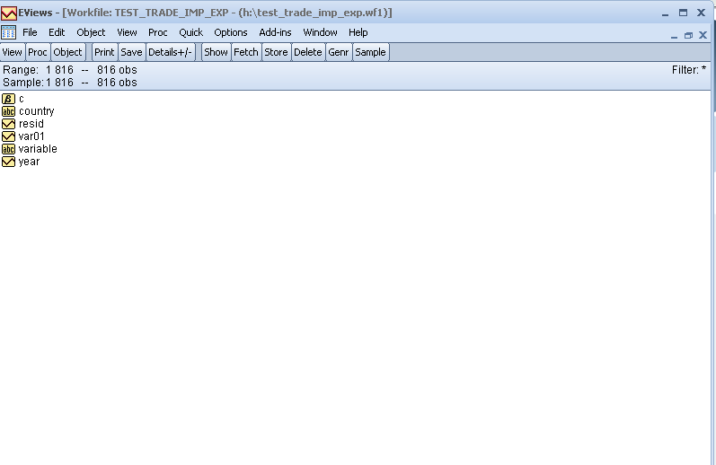

My excel file is almost identical to your second example, Gareth. (pls see excel file attached)
Country Variable year2002 year2003 year2004 year2005
country1 trade
country2 ...
... imp
... exp
But when repeat the same steps as yours, it doesn't seem to work.
After the first step "stack in new page", i get following result(pls see printscreen attached). What should be my next step?
Once I get my data into eviews, the objective is to get descriptive statistics of the proxy variables trade, imp and exp.
Can you please guide me through it?
Tnx Gareth
test_trade_imp_exp.xlsx
(23.77 KiB) Downloaded 5266 times
printscreen
Re: How to enter data into a panel workfile.
Postby EViews Gareth » Wed Nov 02, 2011 8:08 am
From there click on Proc->Reshape Current Page->Unstack in New Page.
Enter "Variable" in the first box. Enter "Country Var01" in the second box. Hit OK.
That will get you to an undated panel. You can then click on Proc->Structure/Resize Current Page. Change the structure type to Dated Panel. Enter "Country" in the Cross ID box, and "Var01" in the Date Series box.
Then you just have to rename a few things to make it look pretty.

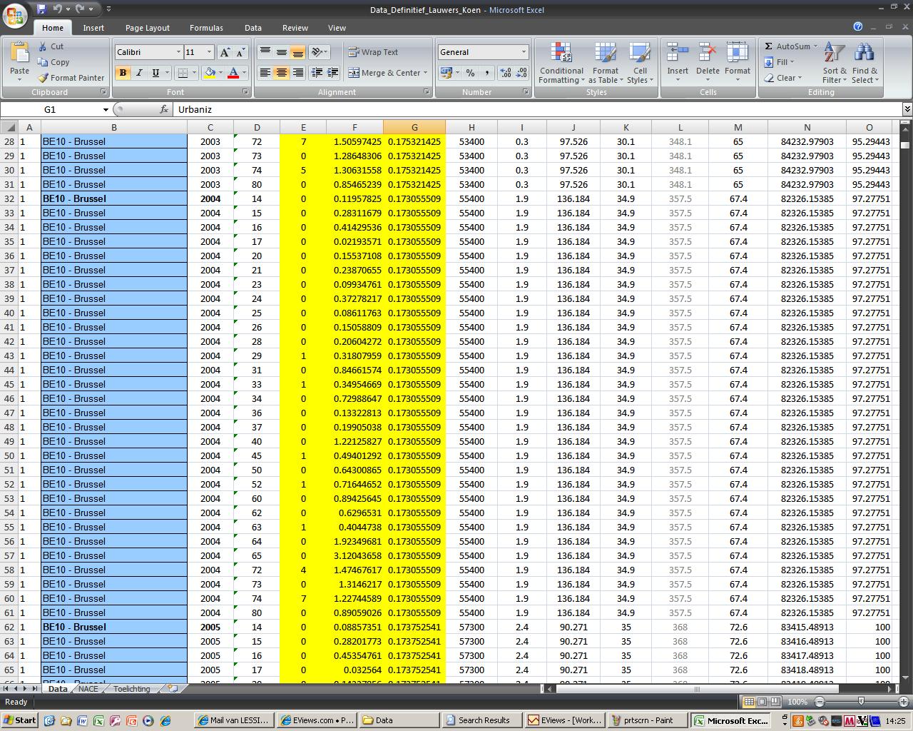

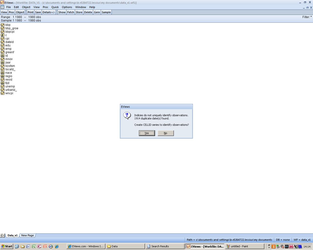

I am trying to convert my data (printscreen2) into panel data.
The problem seems to be however that if I want to transform the data through the normal procedure (Proc - Structure/ Resize page), Eviews does not correctly recognize the years.
This leads to the question in 'printscreen' and this leads to the fact that my data aren't properly converted into panel data.
The structure of my years always is as following:
Region 1:
2003
2003
2004
2004
2005
Region2:
2003
2003
As you can see in 'printscreen2'.
Could you please help me with solving this problem?
Thanks in advance.
PrintScreen2
PrintScreen
Postby EViews Gareth » Wed Apr 11, 2012 7:47 am
Could you post the data?
