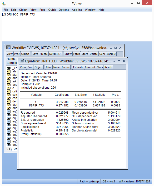

I just did a reboot and opened Eviews as the first program I obtained identical results - error number is the same 1073741824
Support info same.
LS DRINK C 1/SPIR_TAX log(spir_tax)
fails with the same error while
LS DRINK C log(spir_tax) 1/SPIR_TAX
produces answers.

Posts: 2682
Re: error 1073741824
Postby EViews Glenn » Fri Apr 25, 2014 5:07 pm
Good news (sort of).
We've been able to replicate the error. The reason that Gareth wasn't able to see the error is, I believe, due to differences in the global evaluation settings on the relevant machines.
In the dialog for Options/General Options/Auto-series there is a setting for whether to report auto-series evaluation errors in statistical views and procedures. Presumably, bparksb has this set to "Report evaluation errors" and Gareth has it set to "Treat evaluation errors as NAs". EViews is attempting to report the error on bparks' machine as requested, but the error code "1073741824" is not a particularly instructive error message :D. Clearly that has to be fixed, and we'll look at it.
For now, if bparks changes the Global Options setting to Gareth's, the estimation will go through, dropping the missings as required. We'll get the error message cleaned up. Thanks for your patience on this one. It wasn't an easy one to replicate.
bparksb
Posts: 56
Joined: Mon Mar 21, 2011 9:26 pm
Postby bparksb » Thu May 01, 2014 4:33 am
THANKS - that did fix it. Bob
