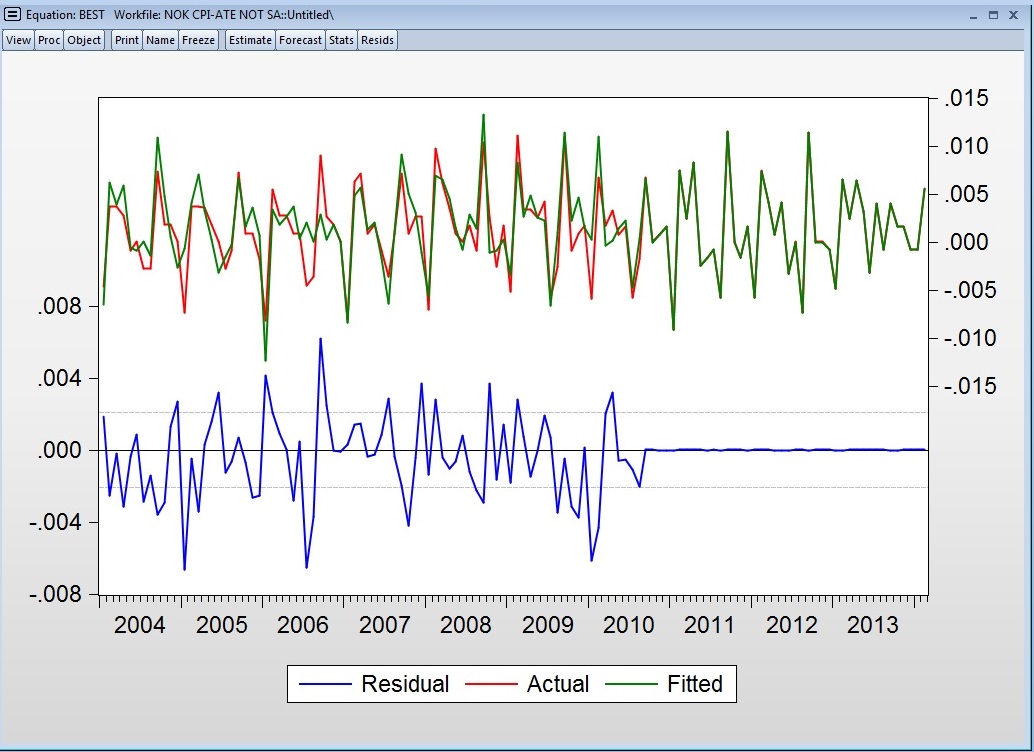

Postby ab00265 » Thu Apr 10, 2014 5:33 am
This attachment might help.
These are the fitted,actuals and residuals. From 2010M9 the fitted pretty much exactly match the actuals, so something is up here.
Posts: 13604
Re: Unable to Static Forecast GARCH model
Postby EViews Gareth » Thu Apr 10, 2014 7:53 am
You probably have missing data over the forecast period.
