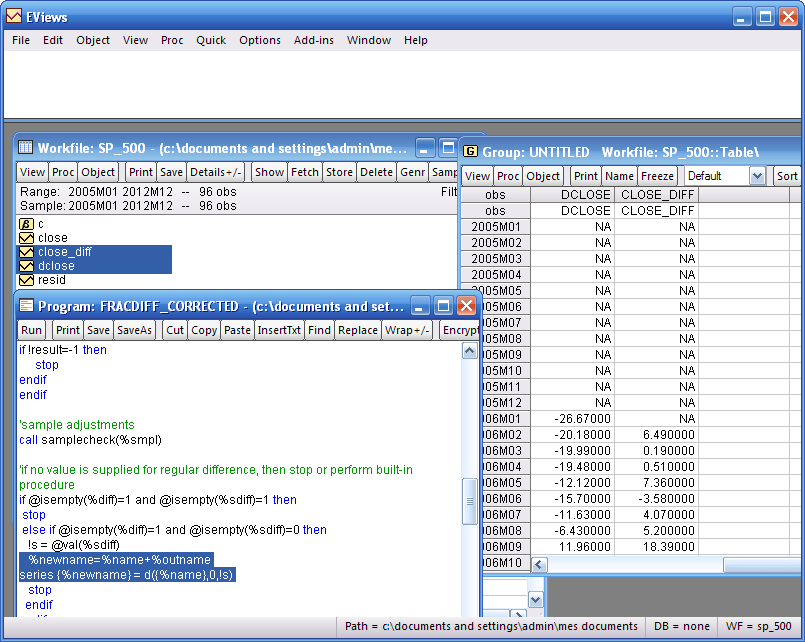

hi, when I use fracdiff for example:
degree of defferencing= 0 and degree of seasonal=12
but when i use genr dclose=d(close,0,12) is not the same result :!:
this is the out put of image.

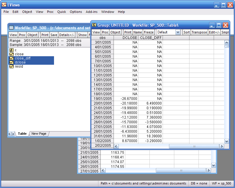

The corrected version will probably be posted in a few days, but you can also get rid of the bug if it's urgent. Just change the Line 76 of the original code:
series {%name+%outname} = d({%name},0,!s)
with the following:
%newname=%name+%outname series {%newname} = d({%name},0,!s)

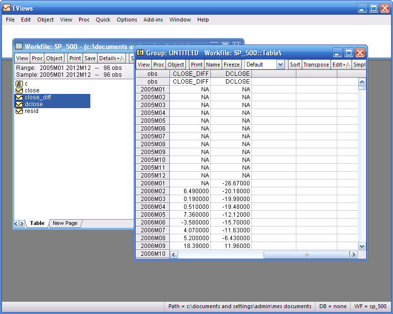

In the meantime, just leave the "Degree of differencing" box empty instead of assigning zero.
ecofin
Posts: 182
Re: bug with fracdiff
Postby ecofin » Tue May 14, 2013 3:49 am
ok! Now it is the same result, thank you very much.
