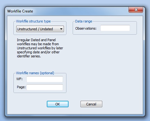

when i want to put it together into Eviews I have to specify number in each column - see attachments (number of observations) - it differs for each day
I suppose that it will be undated data series because each day of the week has different date
So am I right? Is this process by undated data series?
It is not working when I state number of observations as 6 (because of the thurday and monday), others days of the week has smaller number of dates.
The issue is that I have to put each day for each year separately and it takes long time.
Due to this fact I tried to put all days together for each year and test it together for descriptive statistic.
Thank you for your reply
