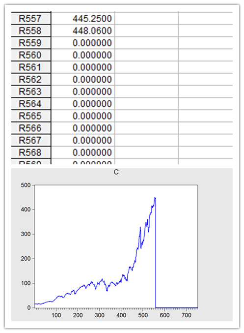

why the sample size is fixed to 751?
portia
Joined: Wed Oct 03, 2012 3:56 am
Postby portia » Wed Oct 03, 2012 4:17 am
I've found mpalmi had the same problem with me. I have only 558 oberservations but the sheet would always tell me that there are 751. Eviews would set the number after 558 zero. This REALLY matters because it affects the mean of the variable and the regression.
Thanks all!
trubador
Did you use forum search?
Posts: 1520
Re: why the sample size is fixed to 751?
Postby trubador » Wed Oct 03, 2012 7:34 am
I think you are trying to edit the coefficent vector "C" in the workfile. If you have undated observations, then you can create an integer dated workfile:
wfcreate u 558
And then, you can create/generate your own series in the workfile:
series myser
You should enter the values into this series.
