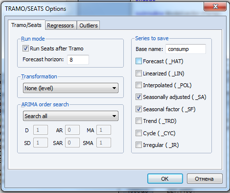

Apparently Tramoseats must support such a thing, as it is usually the result of the dialog box, which I have attached a picture below.

Postby EViews Gareth » Fri Sep 07, 2012 10:04 pm
I don't see it in that screenshot.

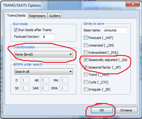

Let`s choose the marked settings and click this buttons. Then, we can have the following result: Y=Y_SA+Y_SF.

Postby trubador » Sat Sep 08, 2012 9:54 am
For monthly series, you can try the following:
y.tramoseats(opt="mq=12 imean=1 lam=1 inic=3 iconce=1 idif=3 iatip=1 seats=2",save="sa sf")

Postby dauren » Thu Nov 01, 2012 10:55 pm
Thanks, trubador! It works!
