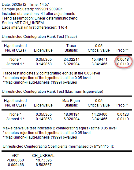

I am still wondering about the purpose of the Cointegrationt test. If you are runing an OLS with differenced variables yoz are checking on co-movement. If you do the Co-integration test, on I(1) level variables, you check on co-integration. Where exactley is the difference?
I am also wondering how to interprete the Johansen Cointegrationr results.
What is the conclusion, if I can reject the H0 in all rows like indicated in the attached file.
If I can reject both, that there is no cointegration, and that there is at most one cointegration vector (two variables). Is it inconclusive? Or can I conclude that there are one or more cointegration vectors, even though I have only 2 variables? I am abit puzzled here
- cointegration.png (24.32 KiB) Viewed 9052 times
Re: Stationarity and Co-Integration
To state the question simple, is it possible for two variables to have two cointegraded relations?
Or can I derive no conclusions from the test results at hand?
