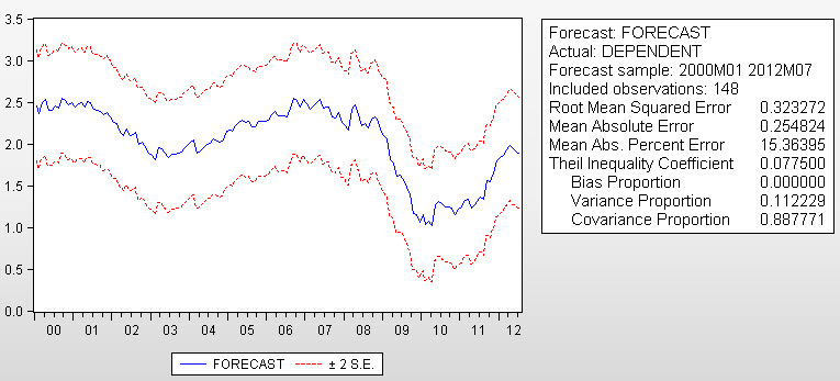

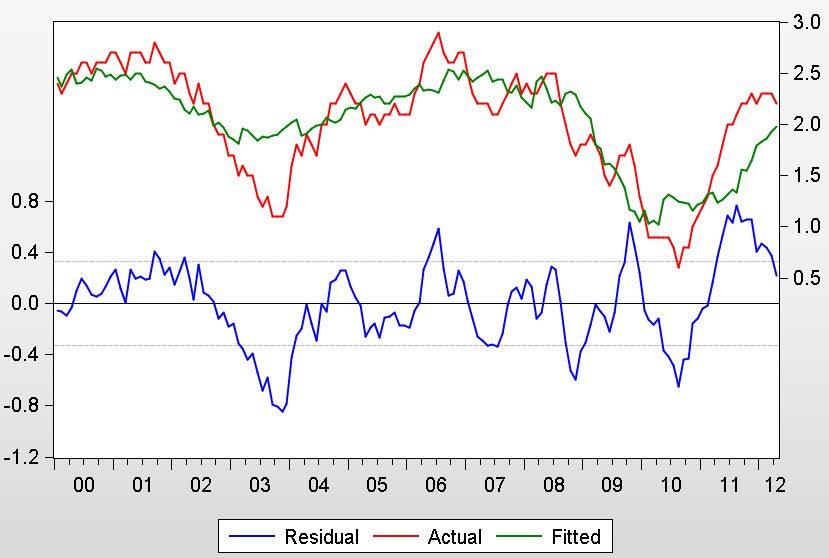

I just noticed that the forecast is based on the fitted (green) line instead of the actual line. Is there a way to forecast projections off the actual dependent variable observations? It makes sense to forecast a projection off the current data, since the data is accepted as "correct".
Fitted vs Actual:
Forecast extends off the Fitted line instead of the actual line
Re: Forecasting = Click on "Forecast" in Equation?
Postby startz » Wed Aug 08, 2012 4:32 pm
Well if you know the value of the variable you're trying to forecast, why not just use that value as the forecast? :wink:
Postby EViews Gareth » Wed Aug 08, 2012 4:37 pm
The forecast will use actual data for all periods prior to the forecast period. Change the forecast sample to start at the end of the estimation sample, rather than at the start of the estimation sample.

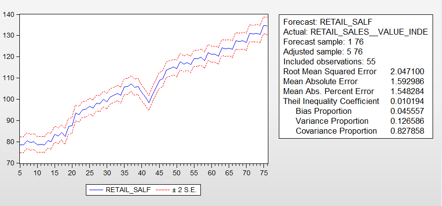

Hi, if I may follow on the question from the OP.
I changed the forecast sample period to start from the end of the estimation sample, and end at a desired point but the graph does not show the historical (actual) values up to the end of the estimation sample, followed by the forecast values.
Am I missing something? :?

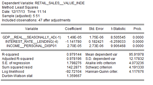

Some stats for info
Jason
Postby EViews Gareth » Mon Dec 16, 2013 8:59 pm
Your first picture indicates that the forecast sample was 1-76, which is, I'm guessing, the entire workfile range.

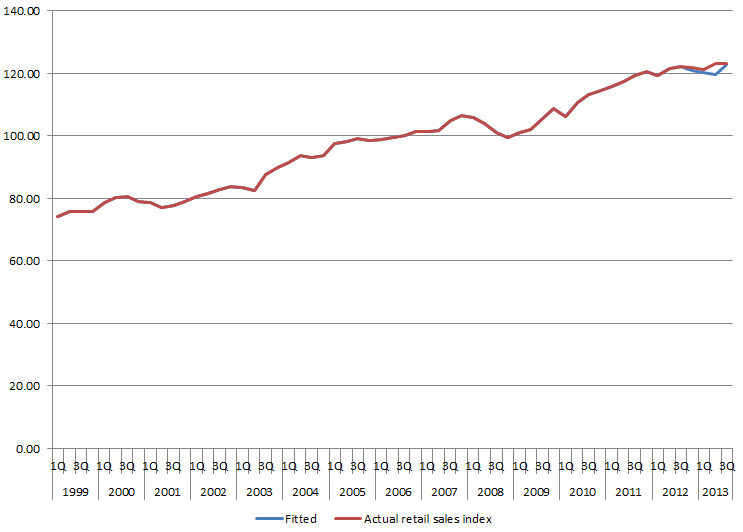

Postby jasonleewkd » Mon Dec 16, 2013 10:54 pm
Hi Gareth, this might be what I'm trying to achieve. The red line is the actual historical data and the blue line is the forecasted. Is it possible, and if so, how?
Actual and fitted.PNG (12.64 KiB) Viewed 8871 times
Jason
Postby EViews Gareth » Mon Dec 16, 2013 11:12 pm
Set the forecast sample
