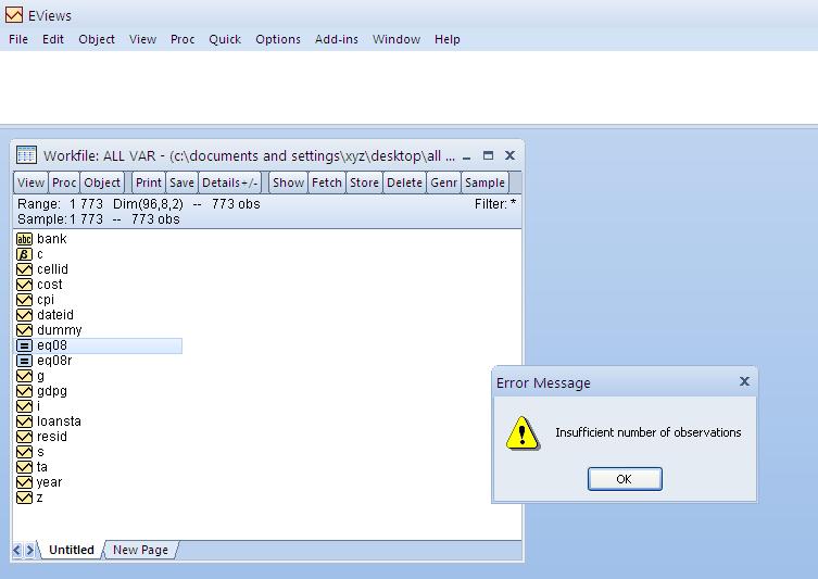

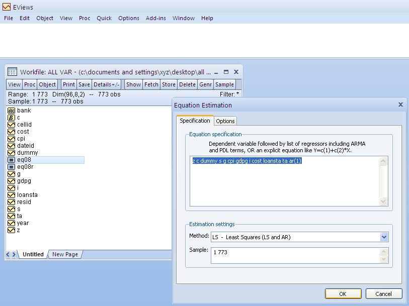

Postby yoyoo » Fri May 25, 2012 8:02 am
I followed the instructions but a message appeared:” Insufficient number of observations”
Attached the snap shots of what I did.
Please help.
Thank you

Hard to say without seeing the workfile. I do note that you appear to have a three-dimensional panel with 2 observations per block. This may or may not be what you want...

Re: Autocorrelation
Postby startz » Fri May 25, 2012 4:52 pm
EViews seems to think the time dimension is your 3rd dimension. You need it to understand that year is the time dimension.

Postby yoyoo » Wed Jun 06, 2012 1:41 pm
It worked after I deleted the time dimension.
